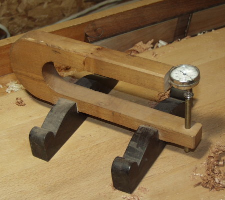

PostPosted: Tue Feb 21, 2006 3:32 pm
Joined: Sun Jan 29, 2006 3:23 pm
Posts: 27
This is a simple thickness gauge. It cost me $20 used for the dial indicator, the wood was from the scrap box. Accurate and cheap and simple to make.
